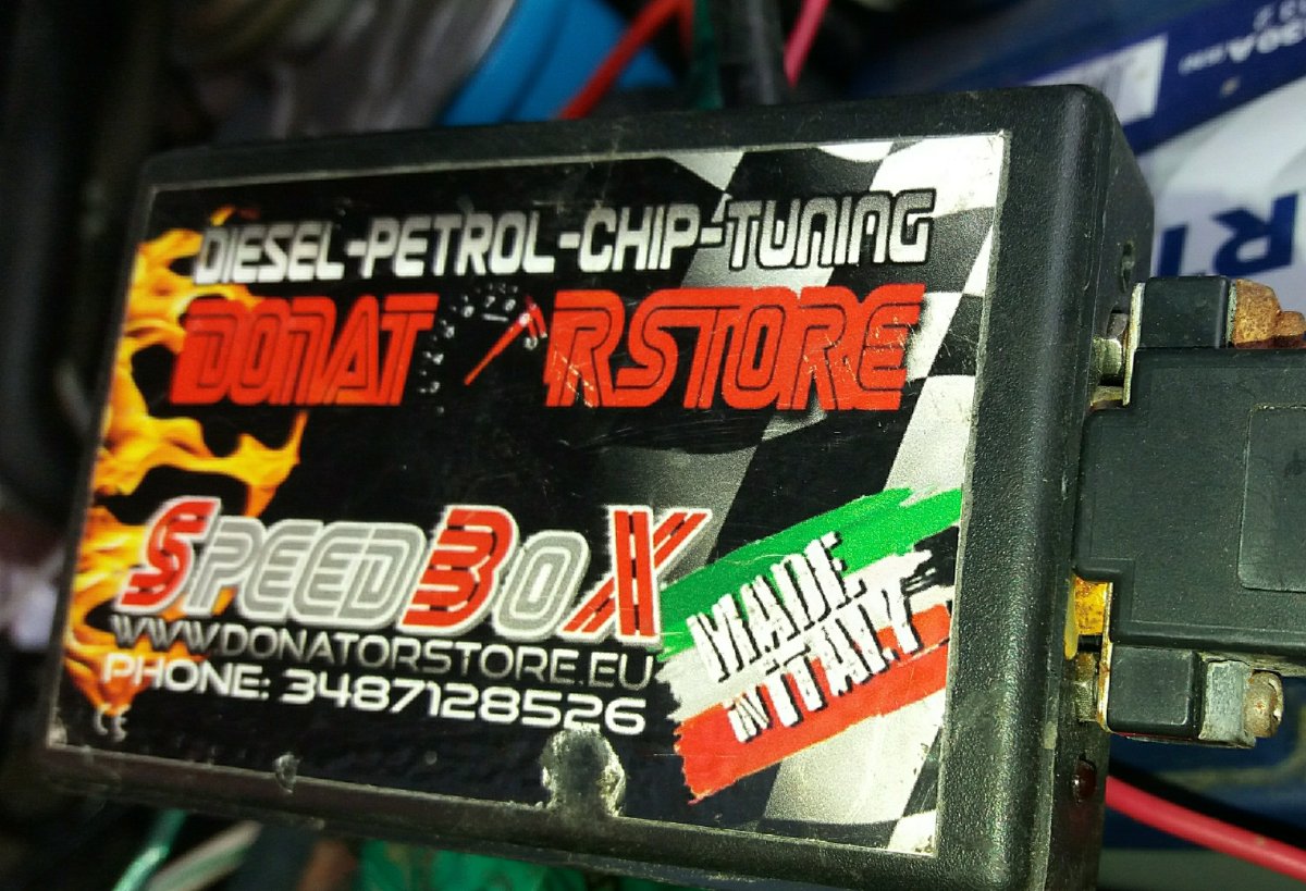

In an effort to rule out simple things, I just removed this horrid thing.
For sure, the actuator was sticking, but for a long time I've suspected this device as causing trouble. I've no idea why someone would add this to a very old car.
Started much quieter than I remember. Yes, the clutch may be at fault. But this was a simple test.
Let you know tomorrow after a longer drive.

Hi Mark,
I had a look at the italian website.
Do you have an electronic pump on your 2.8TD ?
How was this "power box" connected to your pump ? They say on their website the "box' is not delivered with OEM connectors, so I wonder.
cheers mate.
Edit : I had a look at what they offer for my 3.0Di Patrol :
> a MAF booster box, claiming to add 15 to 40HP. This is a joke : they just alter the MAF voltage to get more fuel from the IP, but do not manage the limp modes
> a power box connected to TPS and the pump fuel qty Solenoid only, regardless of injection timing.
I am not convinced at all by their solutions...

Horrible thing, my mechanic who worked on it, put it there because it came with parts. I wasn't asked.
Tomorrow I'll know more. I do have a clutch problem, but only a soft ticking noise. Other than that, no other symptoms, aside from rough idle connected (so far) with flywheel. I hope!
I think this piece of $%$#! Has been giving me false positives all along. I do not recommend anyone installing a device like this.
I have a 30k round trip in the morning. By then, if something bad does not happen, I'll know for sure.
As an analogy. Why fit a pacemaker to someone who does not need it.

Thought I'd update you. I waited for a dryer morning, same approx temps. Same route, same stop, same amount of time at stop. Same route back.
Around 30kms.
I'm happy to report the rough idle is no longer there. I had a dual problem. Actuator and bad after market fuel chip
Now I have to think if I should replace the throttle body to return it back to factory.
