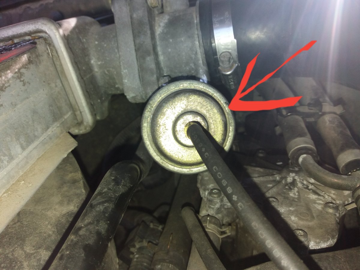

I have a problem with pnuematic air  actuator on my throttle body. I think the diaphragm is too old.
I have searched for a new actuator. I cannot find one.
My question is.....
Is there another actuator that will work on this engine, or a workaround?
RDTD 2.8 1999.
Thank you again. Wishing you all well. 👍 🍺

Are you sure it is the actuator itself which is faulty ? How did you come to that conclusion ?
Did you check the solenoid, connector, and hoses controlling the actuator ?
C'est juste un papillon pour le fonctionnement de l'EGR, afin de bloquer l'admission pour prioriser les gazs d'échappement.
Mettre une plaque pour condamner l'EGR et déposer le volet de l'axe du papillon.
Hi Mark
Here below is the translation of the work-around provided by @rep2559 for you :
"This actuator is used during EGR operation to block some of the airflow and give priority to the exhaust gases.
What you can do is simply install a plate to block the EGR, and remove the shutter from the throttle shaft"

Hi Folks, thank you.
I have an odd rough idle problem. It was quite bad after the engine was at temperature.
I cleaned the throttle body, actuator with maf cleaner. Throttle body too.
I saw that my butterfly valve was OPEN when engine off. I presume that once it is running, the actuator pulls in the throttle body valve, thus providing balance.
What was a constant problem when the engine was at temperature, is now an intermittent one.
I even considered the idle screw was on the wrong side, but after looking at the part. There's no way that actuator could pull it that far through vaccume pressure.
I think the rubber seal on the actuator is at best very old. I know these are not serviceable unless you are brave enough.
I have cleaned injectors with bleed technique, checked fuel delivery, battery and connections are all good.
There is an odd clicking, or even a bad pulley sound from somewhere. I used a mechanic stethoscope, but I simply cannot find it.
The car runs very well, passed its yearly test. But this rough idle and small noise annoys me.
It is now intermittent, but still annoying.
Many apologies. I did not know anyone replied.
Thank you all.
Be well 👍

Apologies. There is no egr on this vehicle. The vaccume pipe has a bolt placed in it. 🙄
I didn't do this. @rep2559 thank you 👍
If you have removed the EGR, as said, either remove the actuator or make it always open.
Modifié par rep2559
@rep2559 Thank you very much. The EGR was removed some time ago. I did not know this, until I had learned more about the engine I have.
What should I do with the vaccume hose(pipe) please?
Block it like the EGR pipe(hose)?
Again thank you. First help I've had in 14 months. Stay safe, well 👍

Si il a bloquer la vanne egr, le papillon ne sert à rien donc pas besoin de le remplacer. Au contraire, il faut le supprimer ou le rendre inopérant. Je pense qu'il a toujours pas compris que ce n'est pas un papillon d'admission comme sur les essences mais juste un composant de l'EGR...
Juste retirer le disque de l'axe (maintenu par 2 vis). A partir de là pas besoin de toucher aux durites, ça n'a plus d'importance.
Modifié par rep2559
Il y a 2 heures, rep2559 a dit :
Ça tourne en rond... lol
Sa durite de vide est bloquée par une vis qui a été mise dedans. Le volet est donc inopérant, et je pense bloqué en position ouverte ?
Sa question initiale concernait son ralenti instable. Et il cherche de l'aide. C'est un anglais qui vit un peu perdu au beau milieu de la Roumanie.
J'avais compris que la vis était sur la commande de la vanne EGR, et non sur celle du papillon. Si c'est le papillon et la vanne c'est bon, mais vu le premier message qui parle d'actuateur défectueux (avec la photo du papillon)... Ça n'a pas trop de sens de s'inquiéter de la membrane et du fonctionnement du papillon si il est schinté lol.
Si c'est juste la vanne egr comme je l'ai compris, ce n'est pas bon car quand l'egr entre en fonction, le volet bloque l'admission et cela étouffe le moteur vu qu'il ne peut plus aspirer les gazs d'échappement.
Si la question est un ralenti est instable ce serait donc plus lié à la pompe et à mon sens il est bon de commencer par lire les codes erreurs et vérifier l'arrivé de gasoil.

@rep2559 Thank you very much! Now I fully understand its operation. Hope this solves that part of the problem. Google's translate fails when viewing a thread. I understand some written French, but nuances will always evade me. Now what can you do about my horrible weather ☺
Thank you again 👍
Ok, here goes.....
Ralenti saccadé seulement lorsqu'il est chaud.
1. J'ai rincé les injecteurs.
2. filtre à carburant changé.
3. La pompe de filtration est dure.
4. J'ai nettoyé le corps de papillon et le maf.
5. J'ai nettoyé l'actionneur avec un nettoyant maf.  Après le nettoyage de l'actionneur, le problème est maintenant intermittent même lorsque le moteur est chaud.  plus je conduis, plus je conduis.  J'espère que c'est compréhensible?  Merci
Update: For anyone reading this.
I just removed the butterfly plate via the 2 screws as suggested by @rep2559
While I was doing this I noticed the actuator stuck, fully closed. After several attempts, it still stuck, quite hard actually.
Anyway its gone. Idle is around 800rpm. A little too high really. Anyway, so far so good.
A test drive is needed now to see if that was the only problem.
